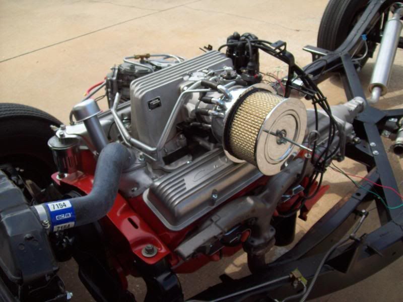

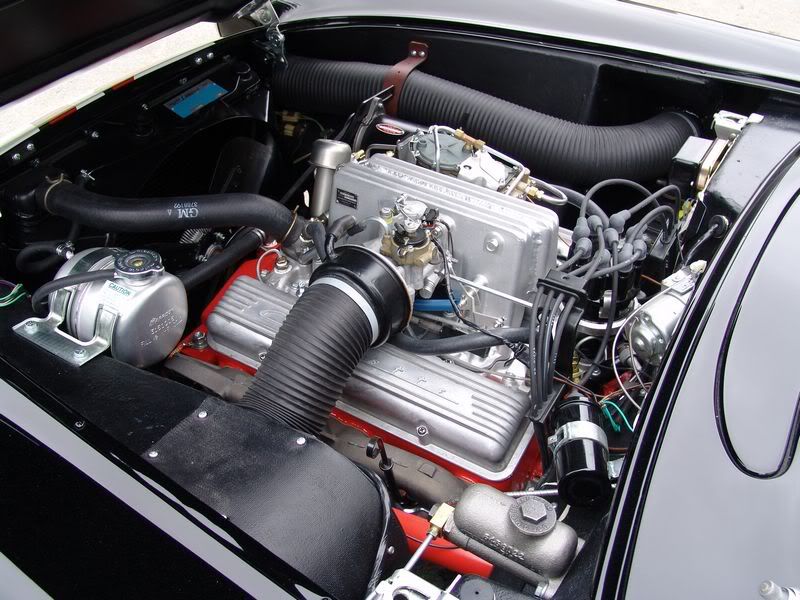

Here are some examples of Vettes with FI and the ducting of outside cooler air that is supplied to the intake side of the FI unit.

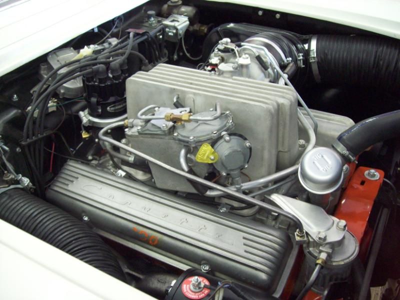

The first pictures are the 57 style airbox that I've added to my 56.
Here is an example of air cleaner on a 57 Vette which is directly over the left exhaust manifold. As can obviously be seen, during high heat conditions (hot summer time), heat rising from the left manifold is sucked directly into the air cleaner.

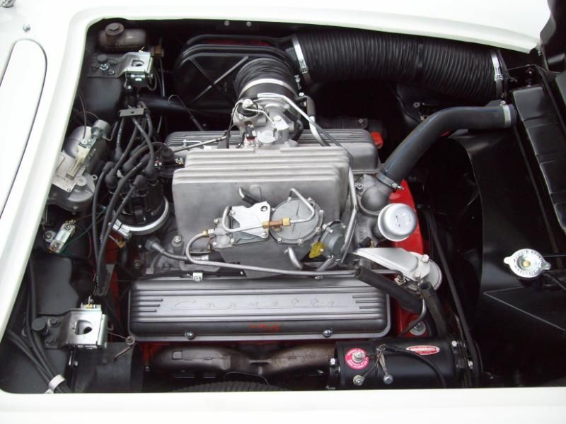

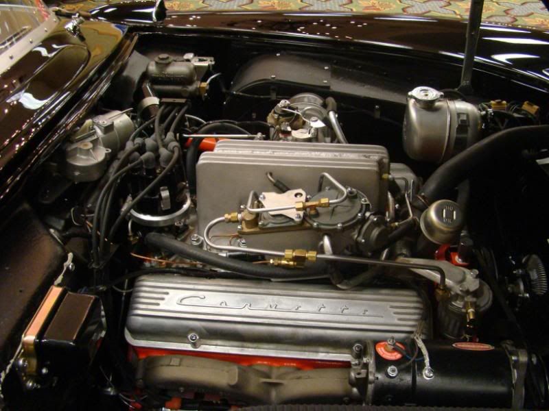

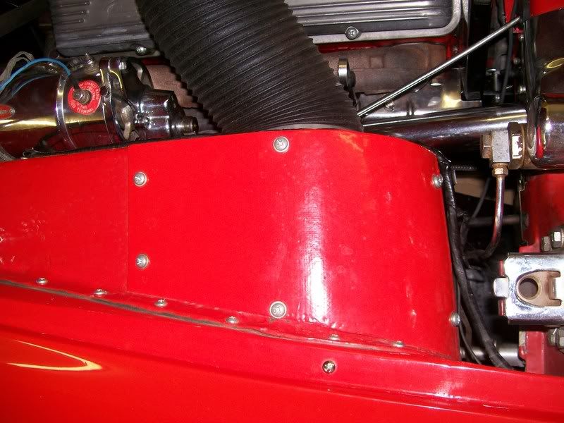

This is one of the original 43 57 Vettes with the airbox option. This one has been setup for racing (and basically, these airbox cars were factory built race cars).

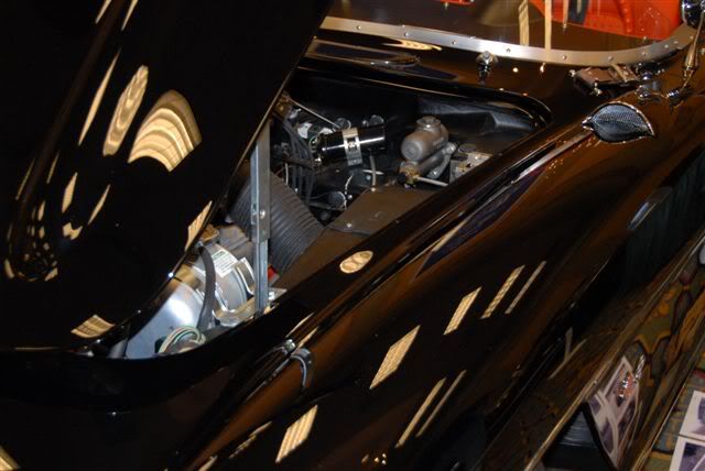

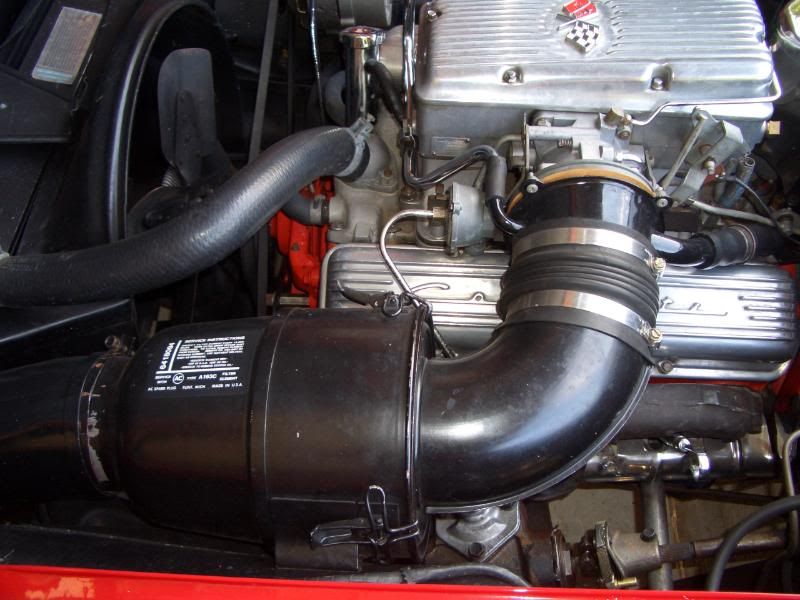

Beginning with the 58 Vettes (up through 62), ALLLLLLLLLLLLL FI cars got an enclosed air cleaner mounted to the left inner fender panel which took in cooler air.
This is the type of air cleaner used on all 63-65 FI Vettes.

THANKS TOM for the fantastic pics and text!!!
I agree Tom, today's gas does not sit well with these old Fulies. It doesn't seem to matter what brand, chepo or branded - it will ALL vapor-lock in HOT, MUGGY weather. I've been adding Marvel Mystery Oil to my gas at fill-ups, seems to help a little to raise the boiling point. I've been told of some Vette guys adding a qt. of diesel fuel to each tank. NO THANKS, as 91 here in Cali is $4.75 and up - my 9.5-283 seems happy with 89 fuel. The 'Widow does struggle on a long slow cruse loop and will stall, but I'm getting better at restarting when it's hot - I don't press down on the throttle as much (not quite 1/2), usually catch it on the first try. I pack a 12v fan and a spray bottle to squirt the lines and spiders when it won't re-fire - haven't used it in a while!
My unit is a '58 - 4900, picks up air from the driver's side sail panel. It would be cool to copy Tom Ordway's scoop and mount it on the core support, notching out the hood brace - I HAVE seen his scoop in the flesh! For now, I'm thinking about ordering the 3/8" lines and sender for the outside of the frame rails, moving the brake line too! ANYTHING to keep the fuel a little cooler...Plus, the car would look more correct!
