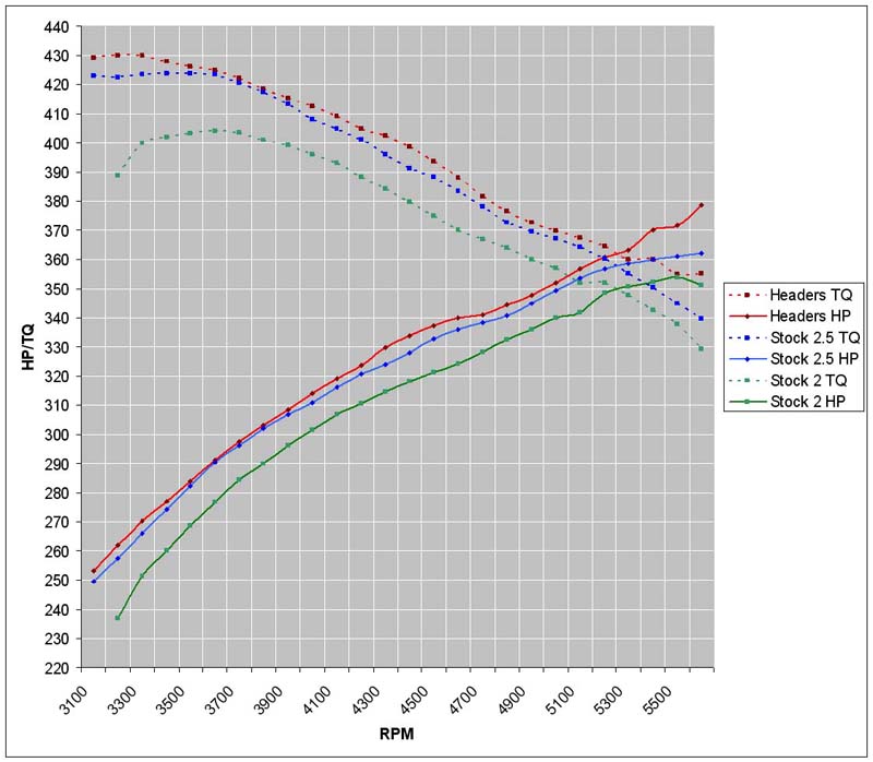

I had my newly built, mild 383 run on a dyno. It is going in my 64 Impala, so good torque was important as was keeping the idle civilized enough for power brakes and air conditioning. Given those constraints and the stock block, heads and intake manifold tow work with, it came out rather well.
YouTube Video of some of the dyno runs
One of the things I wanted to test was the headers vs stock rams horns exhaust manifold topic that seems to come up from time to time. Since this engine is made of stock castings, overall breathing ability is rather limited. So the headers never really get a chance to show much advantage at the extreme top end. The rams horns are reproduction 2.5 inch manifolds that have the correct casting numbers on them. They were mildly ported and the anti-reversion bumps removed.
I have to say, that in my test conditions, using the rams horns is a no brainer. Why deal the disadvantages of headers for such a small gain?
What made a bigger impact on performance was adding the 2.5 to 2 inch reducers to the pipes, to simulate what actually happens at the muffler on the stock exhaust system on the 64 Impala. It also points out that an all 2.5 inch exhaust system would be an advantage.

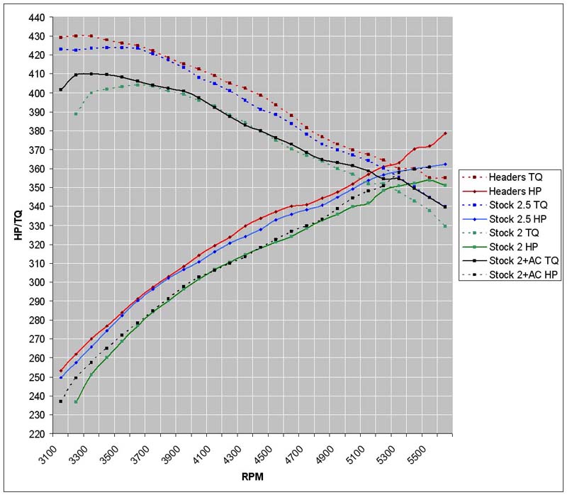

And just for fun I did a run with the stock air cleaner and filter in place, along with the 2.5 to 2 inch reducers on the exhaust (trying to simulate how it will be once installed in the Impala). On a 64 Impala the air cleaner horn has a remarkably small opening and I was expecting it to really cause a hit on the performance.
Surprisingly, the air cleaner/filter had little impact. This is probably highlighting how restricted the intake manifold is. I am thinking it might be worth porting the intake a bit to pick up some more power higher up the RPM range. I don’t think a mild port would have much if any effect on idle quality, since it is a 383 breathing through a 327’s intake.

Id say thats typical.
However....I'll also comment that it looks like the headears are worht about 10 FT/lbs through a large part of the rpm range(pretty consistantly around 10 all through the midrange) and 20 horsepower at peak. I think you would notice those kind of gains more than you think you would.
Realistically...this is the kind of gains seen with a cam swap up to the next size up cam in the "series"(like going from a 270 duration to a 280 duration), but with more low speed response as well. Couple hundred more rpm ability and about a 20 HP gain and mid range gains...but you also found additional low end that the manifolds didnt produce.
Its clear that the manifolds didnt kill it and will still run well and be strong, but I think that as much as this is a successful argument that a good manifold such as yours can do a good job....its also a pretty good argument for headers, that even in a mild app...its worth a noteworthy gain.
On a side note though...who knows how much the additional airflow from the headers changed carb and jetting requirements. In other words....did you jet for optimum results each time?
The gains could have either been larger yet....or actually smaller if both combinations were tweaked for max performance with the given parts you were using.
So as is...its a good argument for what a decent set of headers does even on a mild build, but it just may not be 100% apples to apples depending.
And...were these dyno headers? The operator may very well have a set fabbed up that are better than the "typical" passenger car header....so that also could lessen the gains seen with a header.

thats very impressive info,thank you for taking the time and posting your results, but I must point out, BEFORE you go thinking rams horn exhaust manifolds are almost as effective as headers,.....you need to remember that its the complete combo, not just the swap from headers from rams horn exhaust manifolds alone that can maximize the results keep in mind a great deal of what you can expect to gain from use of headers is dependent on having the exhaust headers tuned to scavenge the cylinders and thats dependent on both the header primary length , diameter,and collectors length and diameter,being correctly matched to the engines displacement, compression and cam timing, and having an exhaust system that has LESS than 1 PSI in back pressure, the best headers in the world feeding into an exhaust system with significant back pressure will result in little gains if any over a rams horn manifold.
Id also point out that when you see a dyno torque curve on a 383 sbc like that that falls rapidly from only 3500rpm, the cam used was very obviously too low in duration for the application and/or the exhaust was restrictive and hurting power (probably the case here) because theres a rapid drop in torque as the engine rpms build , thats almost always an indicator of a restricted air flow rate, it can be because the cams not allowing the intake ports to flow to their full potential but it can be because as the rpms build so does the volume of exhaust gases which increases the effect of any restricted exhaust, because of the rapid build-up in back pressure
your engines torque curve is almost always a good indication of the engine volumetric efficiency

Thanks for the comments. Down the road after I have recovered from the cost of this restoration, I will probably play around with a ported intake manifold and see how that compares. But first I will be running it on a chassis dyno with the engine unchanged to see what the losses are. People say it should be various percentages, but I will able to measure my own as well as get a fine tune on the carburetor. The dyno operator thought the existing jets were a bit rich, but not far off. In his opinion there was not much point in jetting it for the engine dyno, but rather it was best done on the chassis dyno.
The headers used were the dyno shop's headers, so I have no idea how well suited they were for my engine. They did look plenty large and not particularly practical in that they went straight out from the exhaust port quite a bit more than most cars would have room for. And in my case header makers have to be a bit creative to get around the X-frame design in a 64 Impala.
I guess I had the impression that headers were good for a lot more than what I saw. For my situation, where stock appearance trumps all, so headers are out of the question, and I am just pleased I am not paying too high a price to keep the exhaust looking stock. I also do not doubt headers pay off more on a more aggressive engine build, but my constraints with stock appearance and good manners limit things that can be done.
For me, the interesting thought is what the gains were in keeping the pipes at 2.5 inches, and keeping them free flowing. Changing the tail pipes and muffler to 2.5 inches would help in that regard, but I am not sure how much that would cost me in noise.

Dave, did you play with carb jetting? That's your 300hp 327 AFB, right?
Also, you might want to consider 2.5" exhaust back to and including the mufflers, and then go out the back with 2.25" tailpipes. Much of the exhaust energy is dissipated as heat by then, so I don't think the 19% loss in area will hurt much, if any, back there. And the smaller diameter pipes are probably less restrictive than 2.5" mufflers.
One more comment: If those headers have 1-3/4" tubes, I think you'd see more torque with 1-5/8" tubes.

Actually we didn't change the jetting. First off, that is an AFB for a 64 409, so it is not far off out of the box. Second, the Allan figured the jetting would need to be changed again after the engine was installed with the complete exhaust. Third I had been using it on my old engine, a 350 based 383 and it was working.
Yes this whole experiment has me thinking about doing a full 2.5 inch stock exhaust. I seem to recall that the tail pipe would need to be ovaled to clear the tires. It is fairly close as it is. I would also want to see if I can find out how much that would affect noise. I really don't need more noise.
I will have to ask what size the headers were.

Header sets aren't designed correctly. To do it right, two factors need to be built into the pipes.
The head pipes should be tapered larger as they travel away from the exhaust port
There should be an anti-reversion cone set at EACH exhaust port/header flange/tube, at the flange
The dyno testing Jim Fueling and I did years ago, when we developed the anti-reversion headers for Cyclone, showed these two factors really woke headers/engines up, all the way through the rev range.
